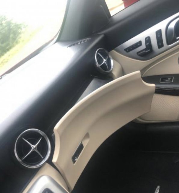

Has anyone else had issues with their SLC’s glove box soft cover separating away from the box in super hot weather? It apparently isn’t glued in place. I’ve approached Mercedes about this, because it seems to be an issue with some of the German cars. I’ve yet to get a response.

I had the same problem with my 2017. The dealership was no help so I fixed it myself.

If you don’t mind me asking, how did you fix it?
I’ve tried contact cement and gorilla glue, but maybe I’m doing something wrong. I wish I could take the door of the glove box off to work on it.

I used gorilla glue. I was very generous in the amount I used and I used a few clamps to hold it for a couple days. It's not perfect but only I really notice it. Good luck
